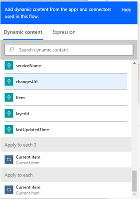

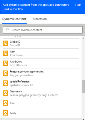

Unfortunately I offer limited insight as I don't have firsthand experience with the ArcGIS connector. If you would provide a screenshot of what the dynamic content options are from the connector that would be helpful.
MK13
 I have attached the dynamic content options. Let me know if you need anything else.
SeanKMcGinnis
Hello @MK13 & @CoffeeforClosers,
Unfortunately, webhooks from ArcGIS Online and ArcGIS Enterprise do not identify which field has been updated, only that the feature layer itself has been updated.
You might want to add it as an idea in the ArcGIS Online or Enterprise communities to provide more detail in the webhooks.
-sean
