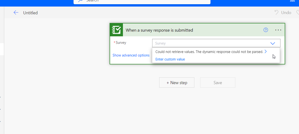

How did we all get on with this?
I found a spelling mistake in one of the field names in my excel spreadsheet in sharepoint (which the submitted survey123 writes into), so I updated the spelling. That has caused my flow to not run properly anymore. Not sure if this is related to the token updates discussed in this thread or the latest ESRI update, but Automate can't seem to find the survey, which it could do before the update. All the original parts of the flow other then the mispelling field name updates work fine. This could very well be an issue on my end though as I'm still finding my feet in Automate. Any pointers would be appreciated.
I tried testing in a new flow too.
