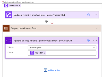

Next, I use Power Automate's built in "Run After" to handle errors by collecting the objectid for all failed runs and then using a second "Update a record in a feature layer" to reset those "TRUE" values to "FALSE" so Power Automate tries again. In the case of issues like yesterday, my flows stopped working during the outage, but then started up again after Esri fixed the issue.

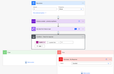

And lastly, it is probably also worth mentioning that I use the "Recurrence" as my flow trigger. In my case, my flow runs ever 5 minutes. Example:
The condition simply terminates the flow when "Get data from feature layer" returns 0 features. If a feature is returned, it continues past this point. This is the expression I used:
length(outputs('Get_data_from_feature_layer')?['body/data'])

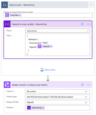

Beyond this, I will mention that there is a "Update a record in a feature layer (batch)" connector which I am not using yet, but may start to in the future as it is much faster for large jobs. It works similar to the "Update a record in a feature layer" connector, but requires JSON as input. Here is a quick example of that as well:
"attributes": {
"prime_process": "TRUE",
"objectid": @{items('Apply_to_each_-_featureArray')?['Attributes/objectid']}
