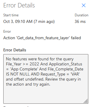

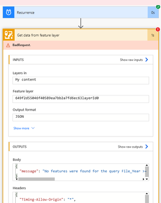

I have 3 Flows which run daily to check a feature layer to see if certain conditions are met. If they are, an email is sent. In many cases there will be no records to return which satisfy the conditions of my query. When this happens, the Flows fail. I am concerned because I do not want the Flows to be automatically disabled by Power Automate after they fail too many times. I need an "escape" so that the entire Flow does not fail when my query is not met.
Here is the error I see:
You recommended I try this solution, but it does not work regardless of where I add the "configure run after to has failed".

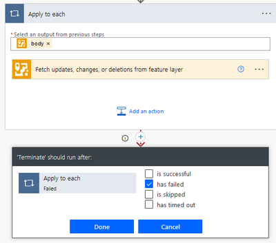

I wonder if it would be helpful to use the Terminate action. It is in the Control action group. It should give you the ability to exit the flow with the status Failed, Cancelled, Succeeded or custom value. I've not tested anything other than Failed so please post back if you attempt this.
PhilLarkin1
Also, in review of your last post, it seems you duplicated the query and set it to run after the fail of the first. If it is in fact the same query it should also fail.
Regardless, you'll need to signal to Power Automate that this isn't a problem even though the query returns no results. Hopefully this branch in your flow is an appropriate place to terminate the entire flow.

As far as the Terminate control... I've actually never used this. I am curious where this would go in the flow.

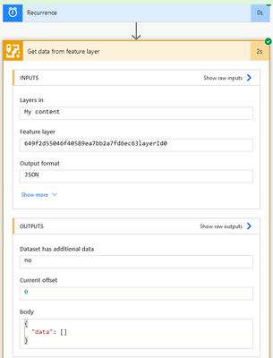

Also, this morning I noticed some different behavior in the flows and I am wondering if @SeanKMcGinnis  and his team have changed anything... I have no features which are returned on the query, however the flow doesn't fail like it was previously. When I check the flow results the outputs also look different than they did a few days ago. I've added two screen captures below for comparison. Now it looks like the ArcGIS Connector is OK with the fact that no results were returned from the query and the flow succeeds without failing.
Original error response received when no results returned:
New output when no results returned, flow succeeds:
Erica
PhilLarkin1
Great! Looks like the connector treats 0 records like a non-failed state. Seems like your problem is solved.
If you wanted to test Terminate you could set it to run after 'Get data from feature layer'. The status should be Canceled, Succeeded, or a custom value. I'm not sure if that allows for the flow to end in a non-failed state. Might be a something to try next time you find yourself in this situation.

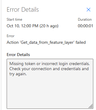

Another issue has come up - I've received this error message out of the blue. Do I need to manually refresh my credentials every 14 days? This Flow ran fine on from the 4th to 7th after your fix was implemented, but failed all weekend.
If so, when will this be fixed? I do not need to do this with the Survey123 Connector. This is really awful if this is what I think it is...
Erica
SeanKMcGinnis
@erica_poisson, I am sorry you think the experience is really awful, but we are working with technology disparities between the different platforms. There is a difference in the way Microsoft and ArcGIS Online grants the refresh tokens and that is what is causing the tokens to expire after 14 days. We are actively working with the ArcGIS and Microsoft teams to come up with a resolution - it is one of our highest priorities.
The near term fix, which is planned to be included in the next release, is using a different OAuth method which will extend the refresh token to 90 days to give us additional time to work through a secure and sustainable solution between the different parties.
The reason you are not encountering this with Survey123 - the submitter's token is being included in the webhook payload. Since the ArcGIS Connector for Power Automate is not authenticating outside of the connection, there is no other way to get a token that can be passed securely given the permissions needed to edit a feature layer.
-sean
Sean McGinnis - Principal Product Manager, ArcGIS for Microsoft
SeanKMcGinnis
@erica_poisson - I wanted to share an update with you. The recent published update to the ArcGIS Connector for Power Automate has extended the token timeout from 14 days to 90 days. We are continuing to have conversations with Microsoft to come up with a more permanent solution, but hopefully this helps.
