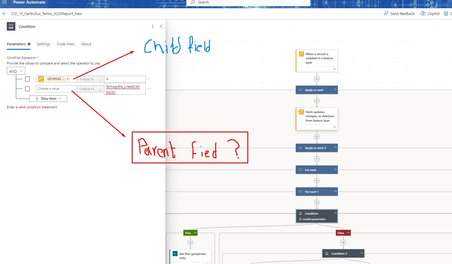

I have a feature layer (parent table, one) with a related table (child reords, many).
In Power Automate i have created a trigger "When a record is updated" with the related table (child records), but i need to call some fields of the parent table...
The idea is to call a field of the Parent Table (see the image bellow), how i call that field
Help please

CORFOPYM_Ingenieria
The idea is to call a field of the Parent Table (see the image bellow), how i call that field?

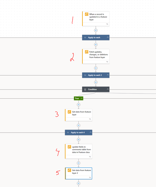

NataliyaLys
I have a similar workflow. And it has been working for me. I'm still new to the Power Automate, so it might not be the best way to handle it, but it works nevertheless.
1. Step 1, I connect to a child table - 'When a record is updated....'
2. Step 2, I fetch updated record from the child table - 'Fetch updates, changes, or deletions...'
3. Step 3, I get data from a parent table - 'Get data from feature layer'
4. Step 4, I update fields in my child table (using fields from parent table) - 'Update fields in comments...'
5. Step 5, I get data from the child table (so i can send it in an email) - 'Get data from feature...'
I hope this helps.

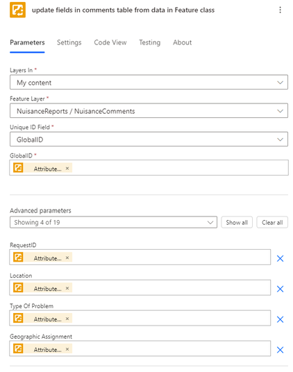

NataliyaLys
Here is how the step 4 looks like:
'Parameters' tab:
'Code View' tab:
