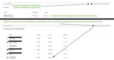

TimLohnes1
Ok. Found the error on the new Microsoft Connections page. See attached if this happens to you. The Connections defaults to New Connections Experience page and gives an error when reconnecting. Have never had an issue before.
Switch the new experience off to get to the previous Connections Experience page. Hit reconnect. It asks to allow the connection to your ESRI account. All fixed.

TimLohnes1

AkshayHarshe
@TimLohnes1 This looks fairly new, I do not see that toggle in my MS tenant and environment. Looks like new connection experience is on horizon. Thanks for this post, hope it will help others.
