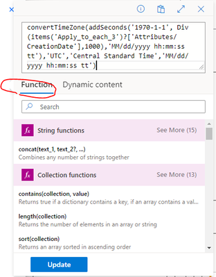

convertTimeZone(addSeconds('1970-1-1', Div(YOURFIELD NAME,1000),'MM/dd/yyyy hh:mm:ss tt'),'UTC','Central Standard Time','MM/dd/yyyy hh:mm:ss tt')
Hope this can help you
NataliyaLys
This is an expression that I have, and it works as expected:
convertTimeZone(addSeconds('1970-1-1', Div(items('Apply_to_each_3')?['Attributes/CreationDate'],1000),'MM/dd/yyyy hh:mm:ss tt'),'UTC','Central Standard Time','MM/dd/yyyy hh:mm:ss tt')
LeviCecil
Thanks for this. Would you do this inside a compose trigger and use the output in the email body?
NataliyaLys
Add it into your email body and an expression/function

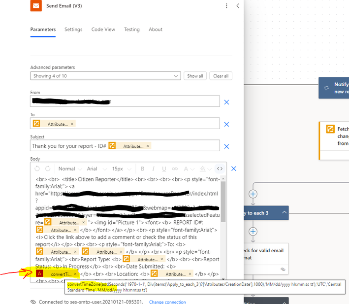

I'm trying this in the email body after fetch updates and keep getting the error "Flow save failed with code 'InvalidTemplate' and message 'The template validation failed: 'The template action 'Send_email_(V2)' at line '1' and column '1842' is not valid: "The template function 'items' is not expected at this location.".'.'."
RobertAnderson3
MVP Regular Contributor
The items('Apply_to_each') implies it's being done in a loop for multiple values. How is your current flow set up? It's just taking the time from one row right? For survey mine looks like @addSeconds('1970-1-1', Div(triggerOutputs()?['body/feature/attributes/startdatetime'], 1000))
Can you share your flow and show where you're bringing the time in and converting it and placing it in the email?
There are also "Add time" and "Convert time" actions that I use in some flows that can read it properly.
LeviCecil
Ah, thanks! I tried it again and it worked!
