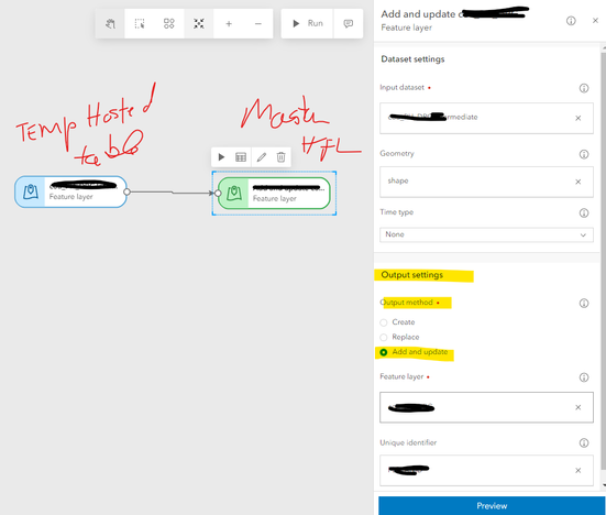

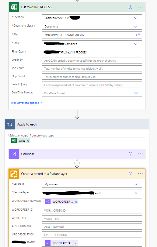

I had a similar process has yours and the way I setup my flow was as follow:
1) I created a dummy hosted table on my AGOL matching the Excel table schema
2) I Created a Power Automate flow that filter the "Active" records from my Excel spreadsheet (I have Active and Inactive records... make sure your Field name do not have spaces in it... apparently it's a bug in the Filter function), then I add new records in my dummy hosted table.
3) I am using Data Pipelines (in AGOL) to update my Master hosted feature layer using the Dummy Hosted table if I have new records or some of the existing records have been updated.
In my case, I am not dealing with a lot of records (less than 200) or live data so the process is fairly quick and I can schedule it to run it every hours.
I am sure there are many different ways to get this process done, I just wanted to share my process.
