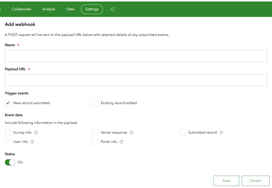

I'm a GIS power user, but I don't work in I.T. In AGOL, I can create/publish items, but that's all I can do; I can't share items or perform any other admin tasks.

Both 1 & 2 would require webhooks in Survey123. It looks like I'd be able to set up webhooks myself using my current AGOL privileges; nothing's greyed out:
