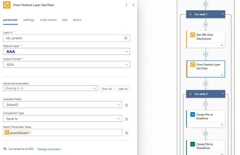

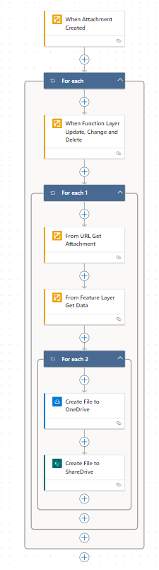

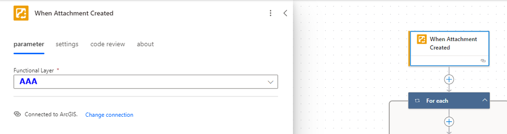

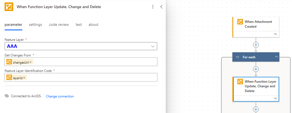

1. The trigger is the feature layer when attachment created.
2. When layer update, change and delete, get "changesUrl" and feature layer identification code "layerId".

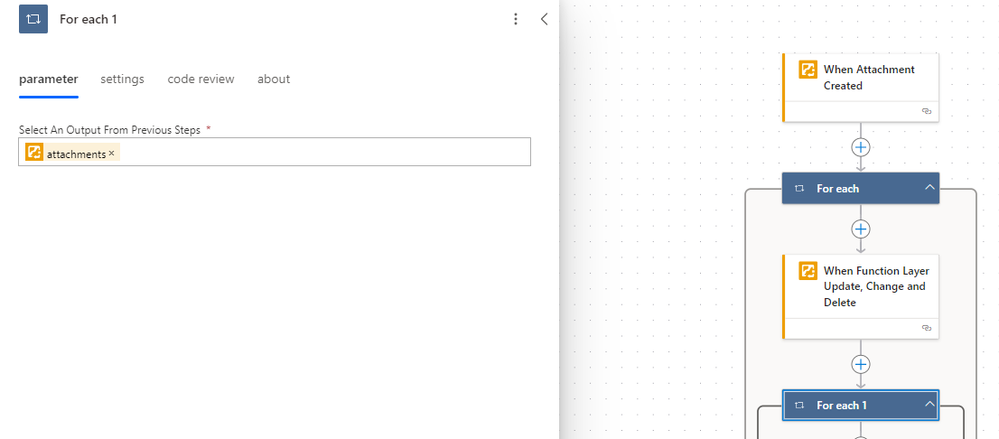

3. "For each 1" loop get the "attachments" data from previous step
4. Get "url" from Attachment
5. To get the object field information, it need to match the GobalID between attachment attribute table and Feature layer attribute table.
6. "For each 2" loop get the field data from previous step for next step

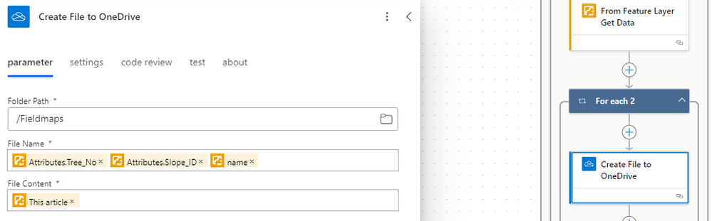

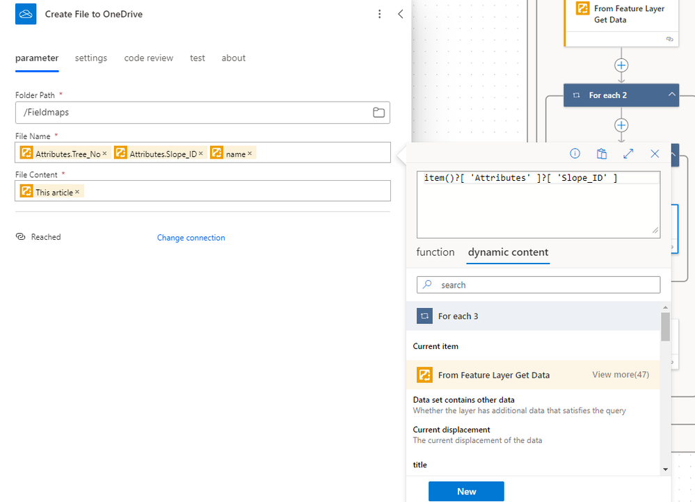

7. Finally, Upload to One Drive or Share Drive and rename the attachment according to the field name
Remark: Some of the valuable cannot insert directly, you need to insert by dynamic content and edit in the text box.
