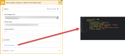

Before fix:
Note that the response is empty, but the "handshake" between Power Automate and ArcGIS Online was successful.

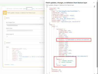

After fix:
Here is the same layer, but with the correct response and information.
