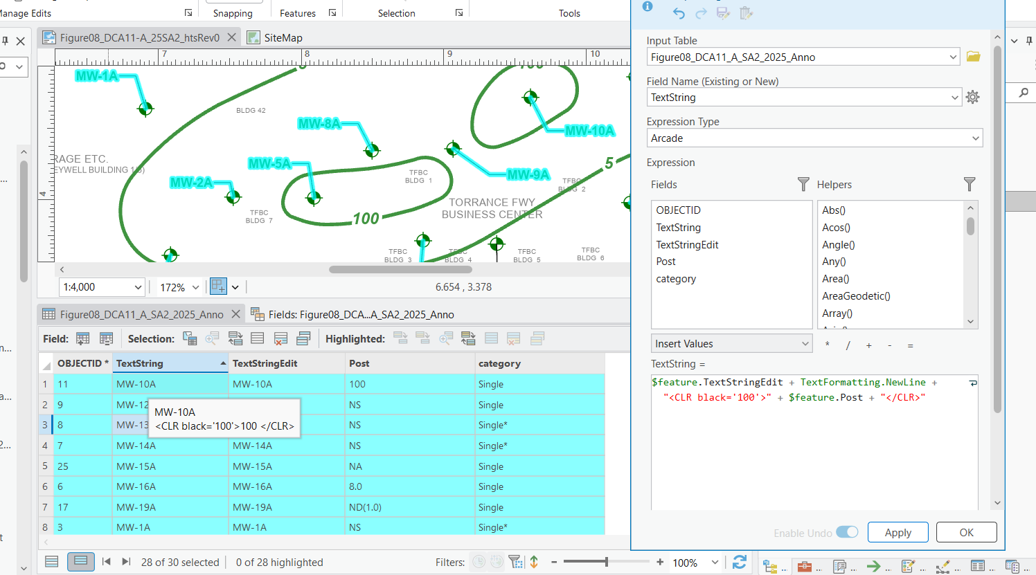

Hi Team,
I have a separate annotation layer, and in that layer, I am using three columns:
  1. Textstring
  2. Textediting
  3. Post
Whenever I post values in the Post column and run the script (either VBScript or Arcade) in the Textstring column, the values are transferred to the Textstring column. They appear correctly in the attribute table but not on the map.
Please see the screenshot below.
I am the only one facing this issue.
