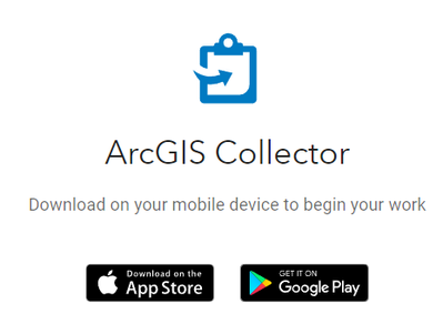

Do the same links that we use for Collector under iOS and Android not work on Windows 10? I tried this but the Collector app is not opened. The attached / embedded screen capture shows page which appears in a web browser after clicking a Collector link in Windows 10. The same links work as they should under iOS.

Hello Paul,
The URL scheme mentioned in the link you've provided is for "ArcGIS Collector" in iOS and Android. However, Collector on Windows is the Collector Classic app, which requires the legacy URL scheme of:
arcgis-collector://?itemID=35b1ccecf226485ea7d593f100996b49
Please see if this URL scheme arcgis-collector:// will work for you. More details can also be found on Esri GItHub at:
