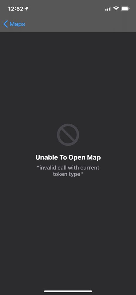

Trying to open existing map created in ArcGIS Online.  Using a global account to log in to Collector for ArcGIS and am not able to load map.  Tested the same map using Collector Classic and have no issues loading the map.  I have tested loading different maps created the same way and have had no issues loading them in Collector for ArcGIS.  I have checked and updated sharing permissions and nothing has been changed on the ArcGIS Online side of things that would usually prevent a map from loading properly.
What am I missing? Thoughts?

I also experienced this issue today. I am running the latest versions of iOS 13.6 on an iPhone 11, Collector for ArcGIS v20.2.2 build 2847, and ArcGIS Field Maps v20.1.0 build 61.
Below are the events that caused and fixed this bug in my scenario in hopes that this may help someone with the same issue in the future:
  • Yesterday: The web map opened in Collector for ArcGIS (iOS) normally
  • Today: I edited the popup configuration of three editable hosted feature layers
  • Today: The web map would not open in Collector for ArcGIS (iOS) or the Field Maps for ArcGIS beta (iOS) and gave the error message 'Unable to Open Map "invalid call with current token type"'

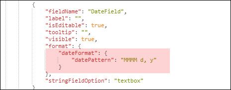

If you have a date field with certain formats in the pop up for a layer in your web map, you may get an error ('invalid call with current token type') when trying to open the map in New Collector and Field Maps while it works fine in Collector Classic.
One example is the following format:
  • "datePattern": "MMMM d, y"

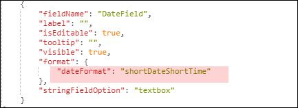

You can check the format of your date fields in the pop ups by looking at the JSON for the web map using AGO Assistant. If you saw a format like what mentioned above, you can change it to "dateFormat": "shortDateLongTime" to resolve the issue.
Alternatively, you can pen popup configuration > Configure Attributes > change the display format for your date field and save the map.
A bug has been logged against this behavior:
  • Synopsis: Opening a web map in new Collector and Field Maps app fails with error 'invalid call with current token type' when the map contains a layer with a date field with a date format "datePattern": "MMMM d, y"
