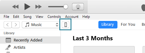

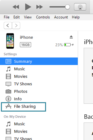

Hi Amy -- Looks like the iTunes UI has changed since our doc was written (I'll work to get our doc updated). In the meantime, in the desktop version of iTunes:
  1. Select your device:
  2. Under settings, select File sharing:
