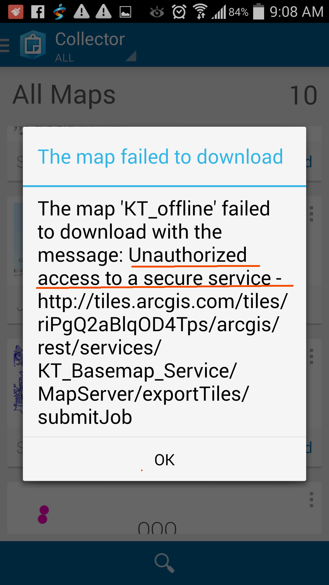

Despite the fact that the basemap was shared with everybody on the ArcGIS Online (AGOL), the ArcGIS collector is unable to download the map to be used offline and displays the following message “the map failed to download with the message: Unauthorized access to a secure service“. It seems that there is a security issue that prevents the tiles to be downloaded to the device. What might be the source of it.

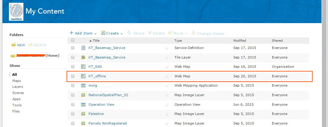

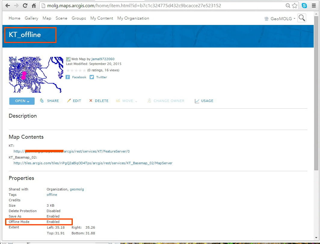

Almost I found the bottle neck, but still don’t know how to fix it. Have a look at the following screenshot, how can I change the access to not secure, it’s really weird!
Sincere thanks

The owner of the map is the Administrator and he can see the map but he cannot download the map using the collector! the admin can see the following screenshot after he login
I didn't know from where the secured access property was gained to this service.
thanks
