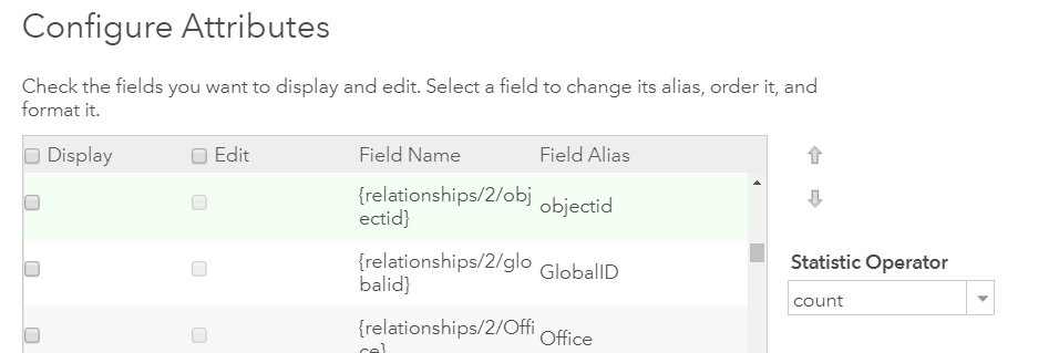

In a web map I use a count on the object id from a Relationship class in Configure Attributes like this.
This is handy for telling me how many related records exist in the pop up like Forms Found: {relationships/4/objectid}
This is not working in the new or old Collector however.  I understand that Arcade cannot do FeatureSetByName and such offline but I would think if the related records are on the device this Count should work.

Also tried using FeatureSetByName($map,"Name") but that did not work in the app either.
