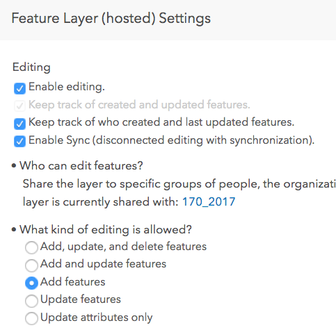

CharlotteSmith4
Attached is a screenshot. My settings were already similar to what you suggested.  I can see the Collector App that I created the fields/domains codes in ArcMap  (shared with the same group), so I'm thinking it's a Pro issue.  Thank you.

Have you added the hosted feature layer to the web map with full editing permissions? When you open the web map in ArcGIS Online, you can edit the layer?
CharlotteSmith4
Isn’t that what the screen shot is showing?
