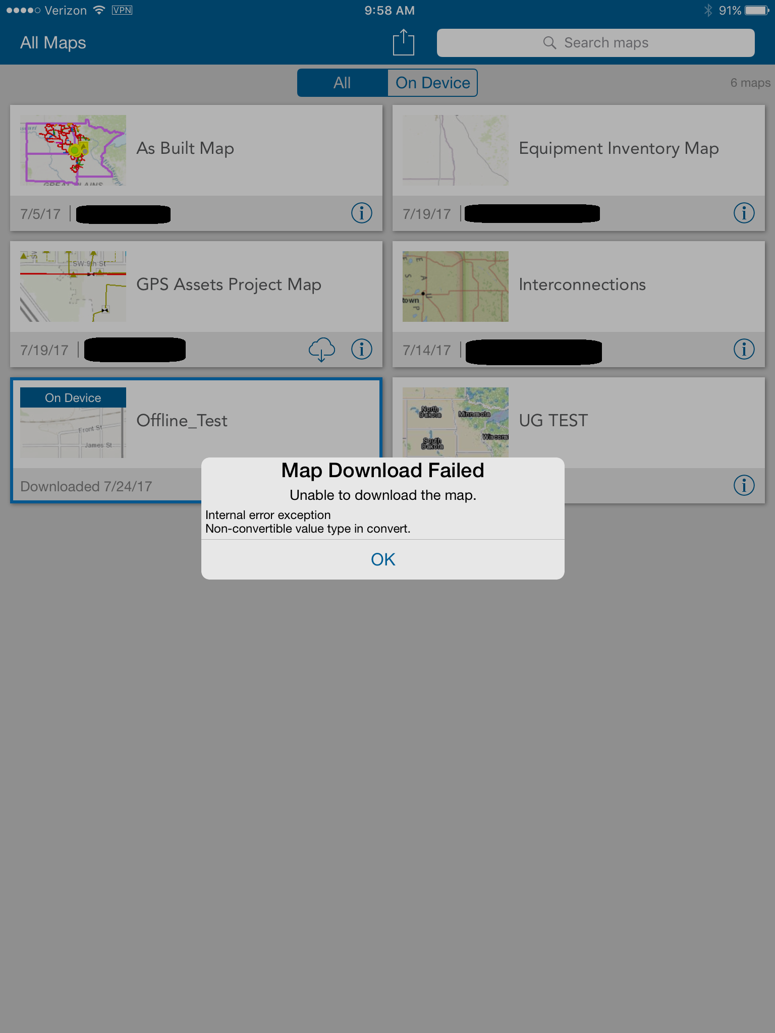

I have an odd error when trying to download a map for offline use in Collector when logged into our Portal. It says the following:
Internal error exception
Non-convertible value type in convert.
I have found no record of  this issue after a search online. Here is a picture of the error:
Thanks for any help!

Aaron,
Does that web map have a geometric network?
BUG-000088516: When creating an offline replica, the following erro..
AaronThompson
Yes, it does.
by Anonymous User
Not applicable
Okay. I would ensure that the geometric network is versioned and meets the requirements in the documentation below:
Supported data—Collector for ArcGIS | ArcGIS
