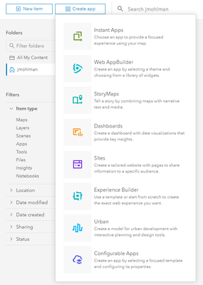

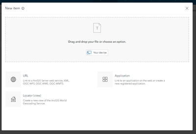

Thank you for your response! Sadly, I do not have the option of "Feature Layer" when I select "New Item". I have included images below of my "New Item" and "Create App" selections to help provide more informationCreateApp_Page.PNG

Totally skipped over that part of your post. This is likely a limitation of your user type or role. Can you have your administer take a look at your ArcGIS Online account within the scope of this documentation? You likely an adjustment to your user role.
