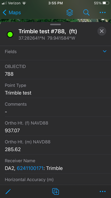

Im using a Trimble DA2 Catalyst with Field Maps to collect survey data, and vertical accuracy is very important for our work. When we collect points in the field we are able to see the Ortho height measurements, but they do not get recorded to the attribute field. I ran through the Project Z process posted in this thread, but I am not able to get the elevations to match what was shown in the pop up in field maps. I have ensured my coordinate systems are all correct and have ran through the process several times but am still unable to get the right numbers. For example, the ortho height (m) shown below is 285.62, but when I run the Project Z tool I get 285.60. Is there any way to get more accurate results?
