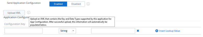

As mentioned with the new release you can now "Use Managed App Configuration with ArcGIS Enterprise" with Collector.  It is great that we are now able to do this, but some guidance as to how would be more than helpful.  Below is a screenshot from the Collector MDM settings.  I tried to follow the instructions for the Explorer for ArcGIS MDM settings setting "portalURL" as my Key and my portal url as my string.  did not work.
How do you do it?

Hey Tucker,
I am not a MDM expect by any means, but I can certainly try to help you. I've used Meraki and MobileIron to set up a "portalURL" for managed devices. What MDM are you using? and what is the version of Collector you're using?
As you learned in the blog post Mobile Application Management and Explorer for ArcGIS | ArcGIS Blog, you'll need to specify three things:
  - key ("portalURL")
  - type (String/Text)
  - value ("https://myportal.com/home")
Once you have these settings populated, you should simply be able to push these settings to the managed devices.
