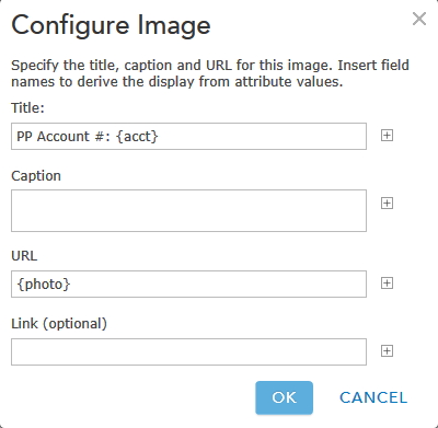

I would like to enable my popup to display a photograph that was taken in the field without having to click on the attachments' link and open a new window. I have my layer enabled to allow attachments, take photos and display the links to the photos in the popup. Currently, within Portal, I have created a map with a feature layer containing a raster field ({photo}) to hold the attachment photo url. In Portal I can attach images and copy the url to the raster field ({photo}). I have configured the popup to take the data in the raster field and display it.
Two problems occur when I try to use the raster field and technique in Collector itself.
1) The raster field {photo} disappears entirely as if it never existed.
2) The link for the photo cannot be copied and subsequently pasted into the (missing) raster field.
I have searched around and cannot find information about how to solve this problem.
Any advice on how to solve the problems will be appreciated.

I have now solved the problem for creating a field to hold the image(s) url. After adding my layer to a File Geodatabase I created a text field to hold 800 characters. I had previously tried to do this but had been unsuccessful. I still do not know why my raster field disappears once in Collector but with the improved text field I can now view images in Collector without having to click on the Attachments link.
I still cannot retrieve the image Attachment URL while in Collector. So I still need to figure out a way, without needing to use a PC/Laptop, to copy the image URL from the Attachment and place in my photo field to display.
