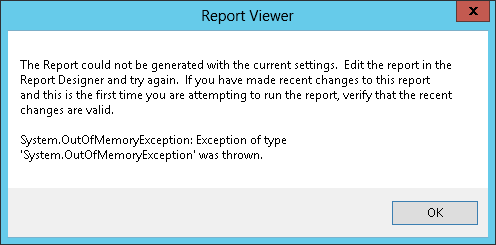

I keep getting this error.

I can get more than one attachment but I can only show one per asset in the report. So in the second picture that I posted above you can see the same asset (Facility ID= 1221) shows up twice in the report because there are two attachments for that one asset.
Does your report run if you only have one attachment?
