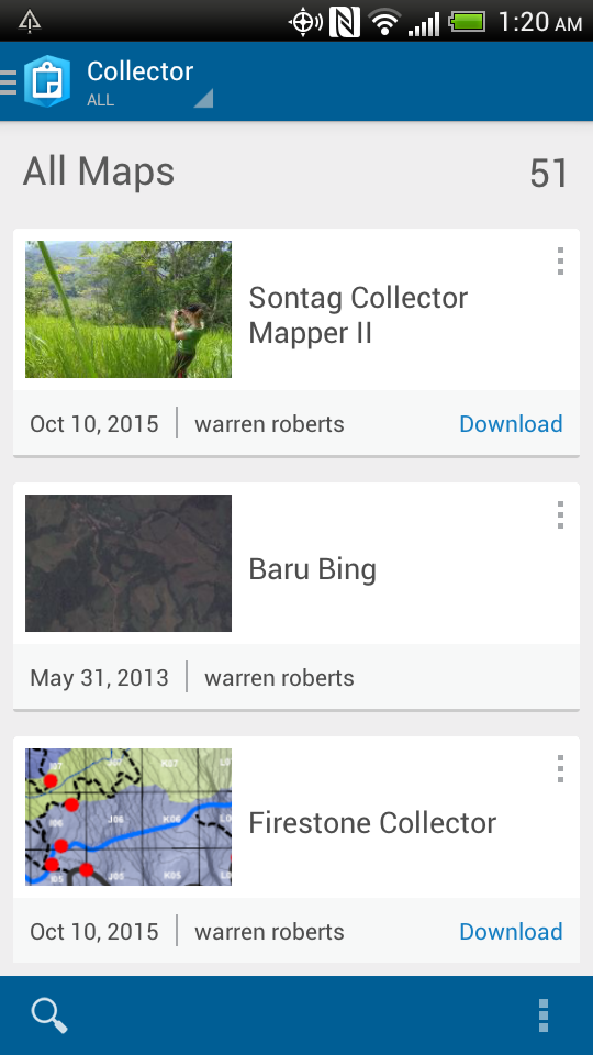

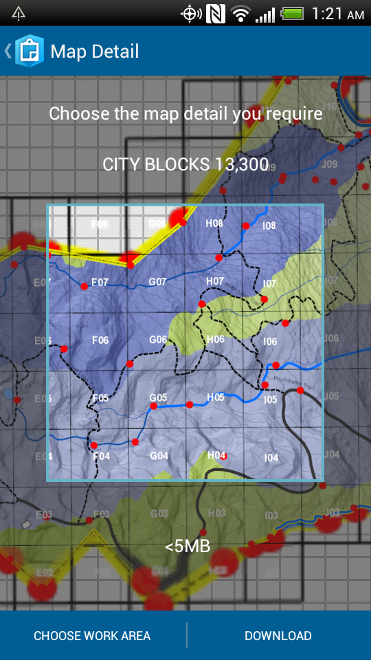

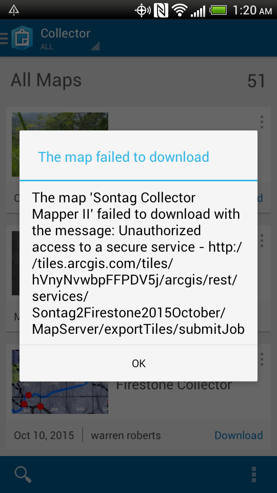

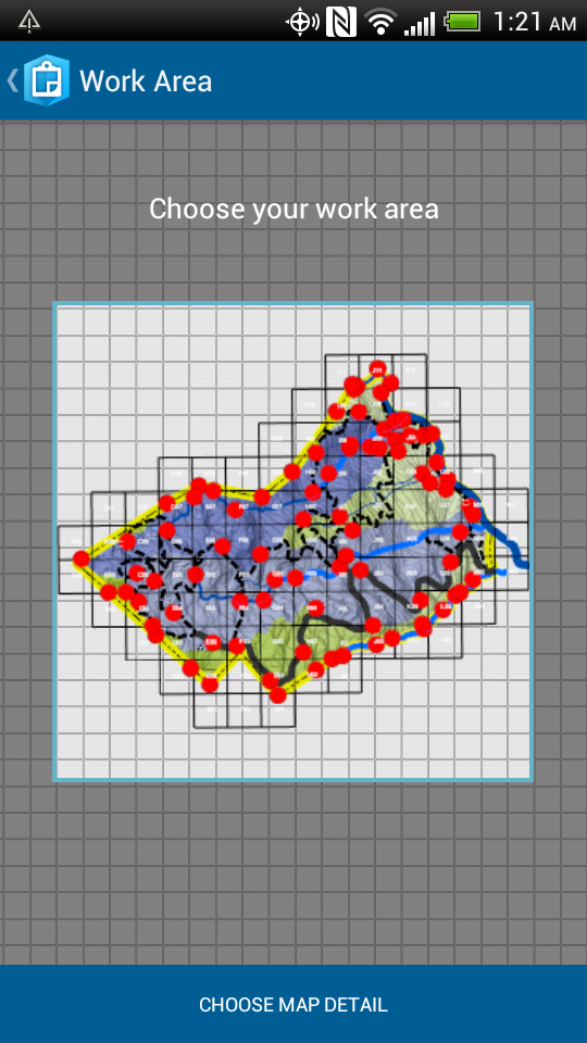

I am attempting to download the basemap to work in Collector .. two options I have been looking.  The one below shows the error in the downloading to permit areas with no service.
2015-10-12_01-20-42.png2015-10-12_01-21-01.png2015-10-12_01-21-07.png2015-10-12_01-20-32.png

For option 1, I think you met this issue: the host tile service is shared to public. If the host tile service is shared to Org only or Group only, it works fine.

thanks!  was part of my problem in addition to the other item with tiles being shared publically .. currently they need to be in a group and not public until Esri can change this requirement

This was the main problem .. thanks  contacted Esri and they also said the problem was the tiles were public and must 1 be in a group .. and furthermore NOT public. And it worked. Thanks!!!
