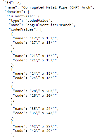

Service domain properties

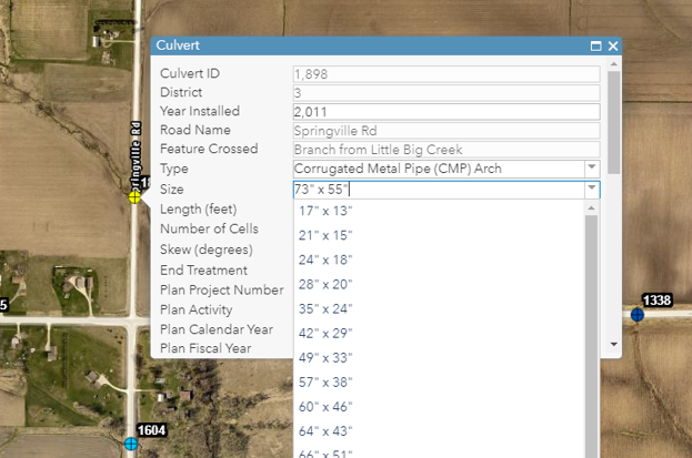

Source web map in ArcGIS Online ... domain values are showing correctly.

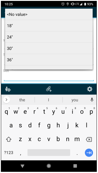

Domain value NOT showing correctly in Collector v18.0.3
