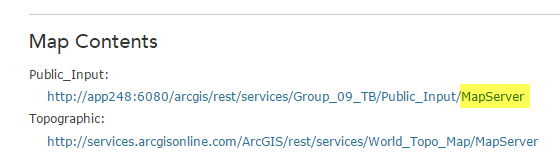

When I go to the map you linked, and I view the item details for it (http://www.arcgis.com/home/item.html?id=88c56c0851ff48069de8cc95736a0723 -- under About you can click "more details" to get there) I can see that your Public Input layer is definitely a map service, and not a feature service:
Perhaps you did create a feature service as well, but didn't add that to the map? You need to make sure the feature service, and not the map service, is what gets added to your map.
