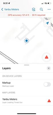

I have a GNSS collection project in the St. Louis, MO area. I am based in AL however so am often out of state while observing collection, or having to test new DB configurations. When I try and load my MO maps in Collector, I receive an error message that the "Layer loading timed out". I am new to Collector, is there a reason why I would not be able to view map layers while out of the state where the data exists? I have tried restarting, reloading the map, republishing the map service, etc..

Hi Allisyn -- You should still be able to open the maps independent of GPS location. I'm guessing it actually has to do with something in the map itself. Are others that use the same map (and are in MO) able to open it successfully? In the app, are you seeing the map load and not show the data you expect, and show that message? If you go to the Layers list (use the overflow menu ... in the upper-right corner and pick Layers) what do you see there? Also, what version of Collector are you using, and what platform (Android, iOS, or Windows) are you working on?

For me, I can open the map and the basemap loads. The layers themselves never show up however. When I click on the overflow menu and select the Layers, it brings up the layers that should be viewable, but there is a red warning triangle with an exclamation point in the center, and under the layer name it says "Layer loading timed out". I have attached an image here showing this.

Allisyn -- Could you tap on the red triangle, tap Share Error, tap message (or e-mail, or any of the options that lets you view the text, as you'll just put the info here), then put that information here?

Here you go --
Domain: NSURLErrorDomain
Code: -1001
Description: The request timed out.
URL: https://gistemp.magnolia-river.com/arcgis/rest/services/MOAW/GISPubMOAWCollectorTest/FeatureServer/0...
