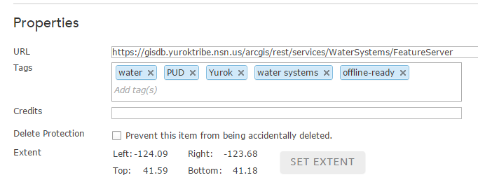

Thank you for the response. I have published the service exactly how you have described and have enabled the "Feature Access" along with "Sync"
Of the published content in Portal. These are the only properties of the web map and it will not allow me to "enable offline mode"
These are the only properties of the feature layer within the web map:
