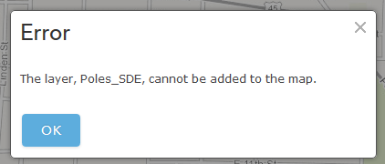

VenusScott
Here is what I get when I try to look at your map:
I've seen this when feature or map services are not allowed through the networks firewall.
AnnKitowski
Deactivated User
Thank you Venus for posting this error message.  I will look into this.  I'll post back what I find out.

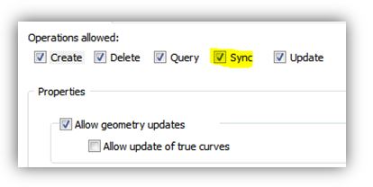

JoeFlannery
Honored Contributor
Ann:
Server-side: At 10.2.2 one is able to enable "Sync" in the map service at >Feature Access >Operations Allowed.  Could that be your issue?  Are you using ArcGIS for Server 10.2.2 or 10.3?

AnnKitowski
Deactivated User
Thanks Joe.  I'm using 10.2.1.  In this version I can see the "sync" checkbox, but when I check on it, it brings back a message saying I can't use it.  But I don't think I need to use the offline editing capability (not yet anyways).  But does having this function even matter when using the ArcGIS Server feature service in the Collector app?
JoeFlannery
Honored Contributor
No, I guess it doesn't matter.
