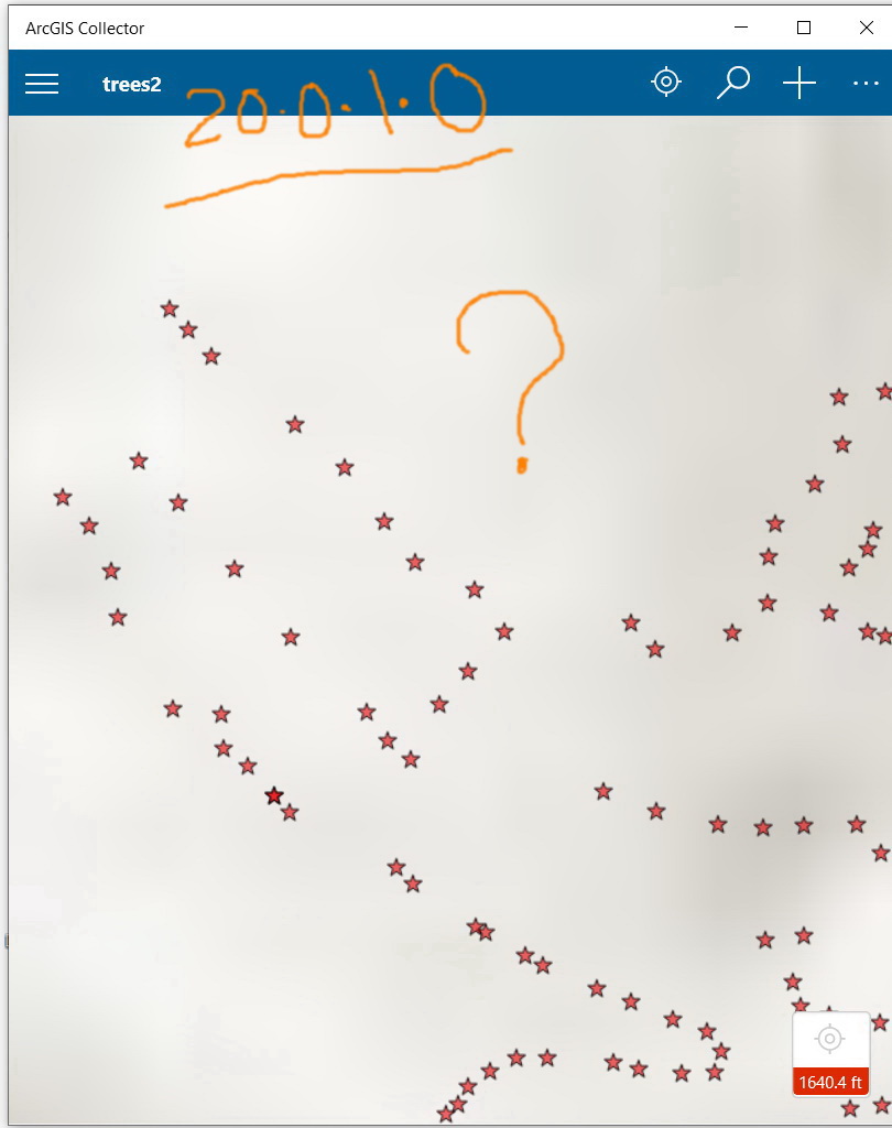

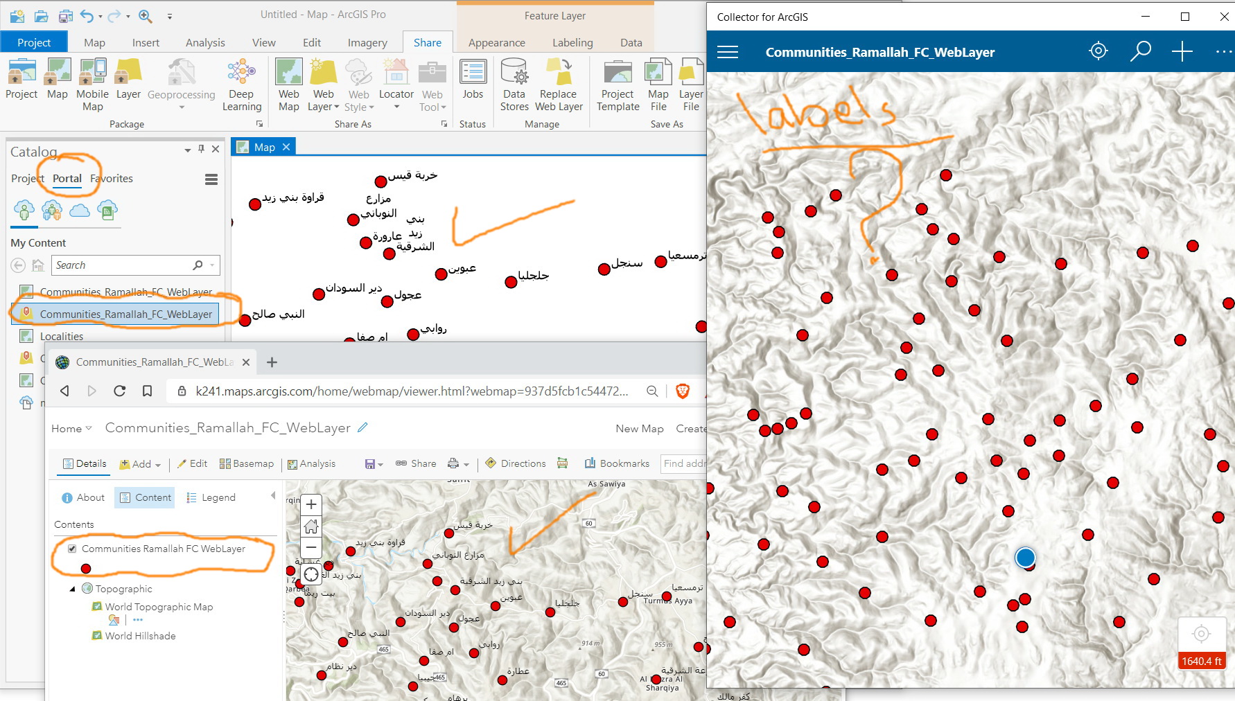

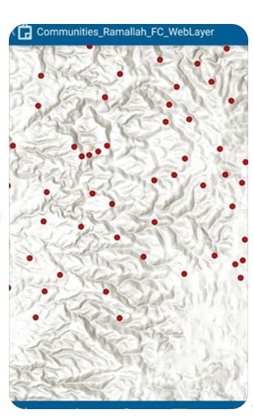

ArcGIS Collector 18.0.2.0: The collector fails to display labels of a service,
Despite the fact that labels of a service published in ArcGIS Online and web map viewers are properly displayed, Collectors fails to do so
What could be the issue here?
Labels aren't currently supported on Windows.

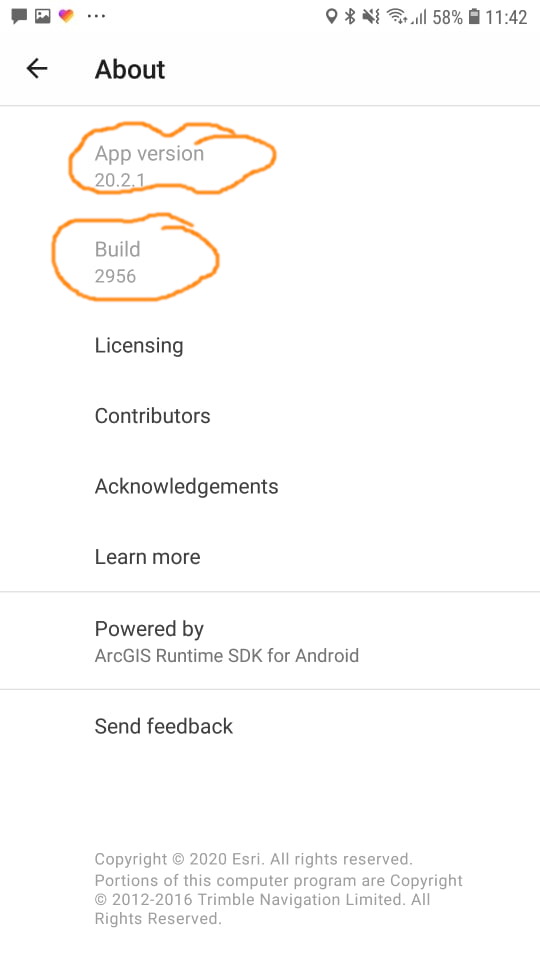

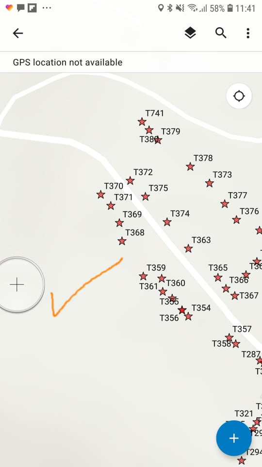

I have the same issue with the android. The labels are not displayed
The released Android app doesn't support labels, either. However, they are supported in the beta available now, and it is scheduled to release later this month.

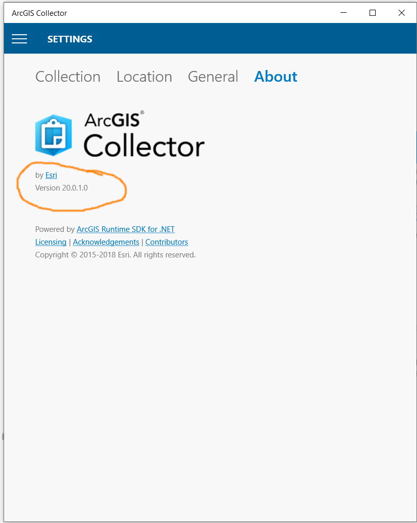

Is there any plans about supporting labels on Windows Collector? This would be so helpful.
It appears that displaying labels is implemented in version 20.2.1 for Android but still not available in version 20.0.1.0 for windows
Collector on Windows does not yet support more recent functional additions such as labels, ArcGIS Arcade, etc. At this point we have paused new development on Windows 10. For more details, I'd recommend having a look at Jeff Shaner's reply to this post, which provides some insight into our plans for Collector on the Windows 10 platform. If you are interested in seeing Collector or our latest app ArcGIS Field Maps on Windows 10, I'd encourage you to send an email to esriApps4Windows10@esri.com with details on how you're using Collector on Windows today.
Just I wanted to know if more functionalities and capabilities are scheduled in the upcoming releases for windows
Jamal NUMAN as the blog post outlines, we don't have any firm plans at this time.
