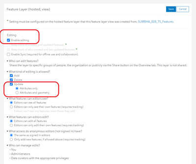

David_Brooks
Create a view layer from the original feature service and then enable attribute editing only:
Andrew-Bowne
@David_Brooks suggestion only seems to work with hosted feature layers.
easchwe
Agree with @Andrew-Bowne, all our layers are reference from the database, eliminating the ability to create a hosted view layer. Is there a way to accomplish this without publishing a second version and creating another service?
JCGuarneri
I agree. Especially with the Utility Network features, it would be great to not have to publish a second feature service.
