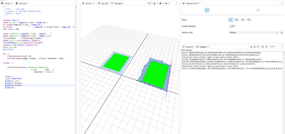

Thank you Jonas for replying, as you can see from the image below , the console results of the rectangle is something of the first step I want to achieve as the intial state of the polygon have the same amount of edges as the final stage and that there are two arrays showing there initialand final edge lengths. But in real life the polygon we get are  more like the polygon on the right and hence there is more stages in between to reach the final stage. Hence I would like to know how to store the arrays of the inbetween stages.While having the ability to reuse it t later stages or until it is overwriten.
Attached are the sample file thats similar to what I am currently using. Using set attribute operation to create a simple lookup table, but it is only good if the polygon doesnt have a many edges, and that at the later stages the extruded level are limited to single digits. Other wise it will be very messy and creates so much redundancies handful.
So if an array can be used in a function(rather than as a global declearation) while its result is global and be used any level child of the parent polygon like the Set operation for constants and floats,

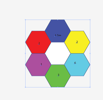

As for the second question can you please provide a proper setbackPerEdge  example for  the white polygon in the image below, as each colour representing  zone requires a specific setback distance.  Here where none of the setback selectors have a solid relationship with the adjacent polygon. except for manually changing the edgeAttr function

Here is a basic example of setbackPerEdge:
const setbackDistance = [1,3,6,2,1.5,2] // connect this attribute to the object attribute on your shape with the same name
dist = setbackDistance[comp.index] // or edgeAttr.getFloat() when you want to use edge attributes
Lot --> setbackPerEdge(dist) { all = Green | remainder = Blue}
when getting the distance from an object attribute you need to make sure that you define the first edge accordingly.

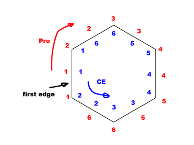

In theory yes but it could be that the relation from your list is not the same in CE and pro, because the vertices/edges order is the otherway around. So when importing from pro the first edge will be matched to the first edge of pro, but the others are different:
verticeAndEdgesOrderDifferenceBetweenCEandPro.pngverticeAndEdgesOrderDifferenceBetweenCEandPro.png
