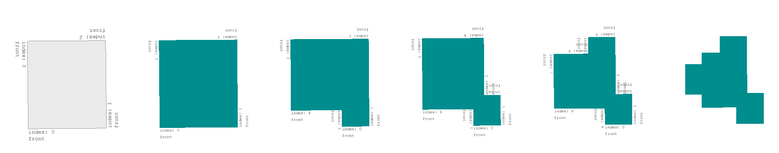

I'm using setbackPerEdge to perform setback operations using a array. I use the edge indices from comp(fe){all: comp.index} to perform different operations dependent on the index I get back, which requires the indices of edges to not change, or change in a predictable manner.

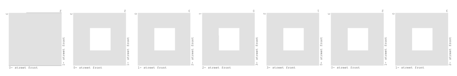

When I use the setbackPerEdge after having used a shapeO (or setback operation to get the same result)  the new leaf shape has it's edge indices permutated compared to the origin: here is an example where I have a rectangular shape as an initial shape(left) and as we go from left to right we first create an ) shape, then we apply setbackPerEdge a certain number of times as seen in the image bellow:
at each point I'm translating the shape and visualizing the edge indices of the new shape. As can be seen, the first application of shapeO maintains the edge index order - while adding the new ones at the centre. as soon as we start applying setBackPerEdge to this new shape the edge indices start to shift 0->1, 1->2, and so on.

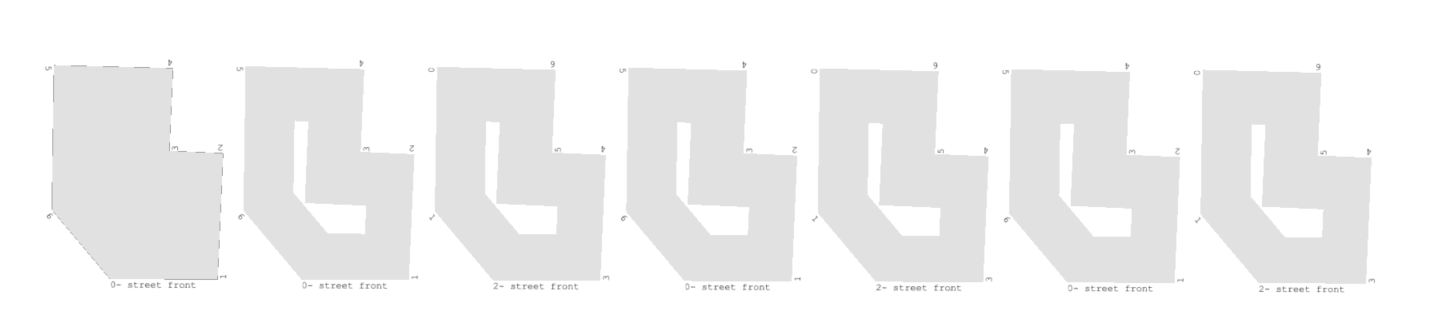

If we do the same operations on a slightly different initial shape the indices shift in a different way as shown below, where 0->2 and then 2->0 in an alternating way
how do I maintain the indices consistant or keep record of how they change in a predictable manner so I can use them reliably?

MartinManzer
Hi @Mateo_Neira
Unfortunately this is a bug: A setback operation will change the edge indices in an unpredictable manner. This only happens on shapes with holes as it is the case after your first setback operation. We added this issue to our backlog. Thank you for reporting!
Setbacks on shapes without holes do no change the edge indices.
Selectors (for example street selectors) are not affected and can be used to assign distances or perform a mapping to an array (like you do).
Best,
Martin
