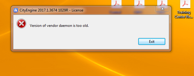

I used CityEngine all day yesterday with no problems. This morning, I opened CityEngine and received this error: "Version of vendor daemon is too old."

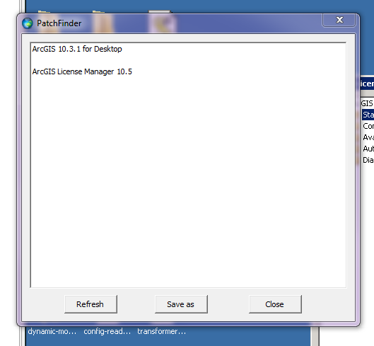

I did a Google search and found a suggestion to run ESRI PatchFinder to make sure the license manager and desktop versions were the same. I'm running ArcGIS Desktop 10.3.1 and License Manager 10.5.

You will need to install License Manager 10.5.1 or higher for CityEngine 2017.x.
