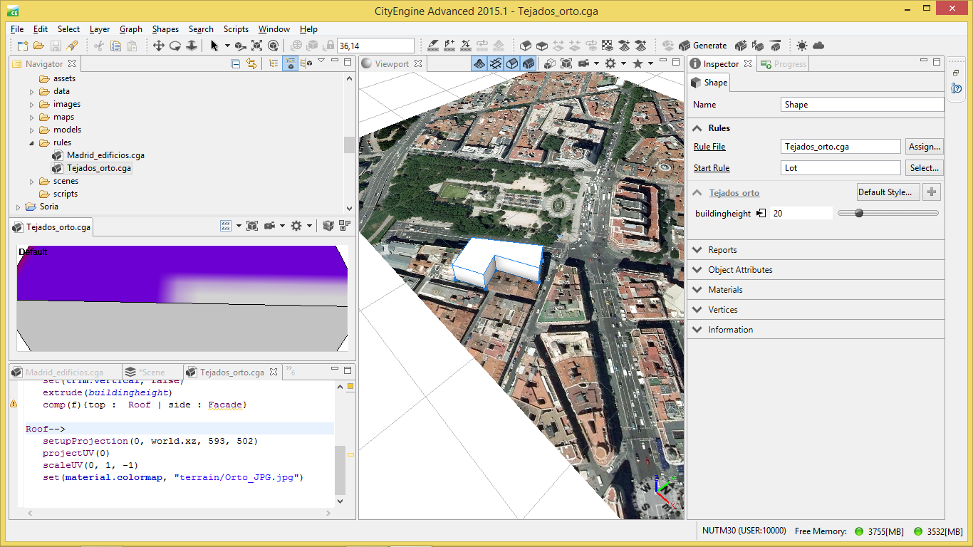

Hi,
I was looking in the help section of city engine and I found something about this.
In the "setupProjection operation" we can see this code:
attr buildingheight= 20
Lot-->
  set(trim.vertical, false)
  extrude(buildingheight)
  comp(f){top : Roof | side : Facade}
Roof-->
  setupProjection(0, world.xz, 586, 442)
  projectUV(0)
  scaleUV(0, 1, -1)
  set(material.colormap, "test_0102_ortho.jpg")
I have used it but i can´t assign the texture of the ortophoto to my roofs...

BenLeslie1
This is what works for me:
Roof-->
  projectUV(0)
  texture("test_0102_ortho.jpg")
