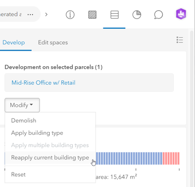

RPK files can include the CGA source code along with the binary version. For the Urban.RPK this is not possible, since the methods used are an essential component of the Urban app.
Please note, that only changes to the Model's parcel attributes in an Urban plan are saved back. In the Urban app, the plausible buildings need to be regenerated.
To create Existing buildings in CE, the recommended way is to export to fileGDB and publish in ArcGIS Pro.
