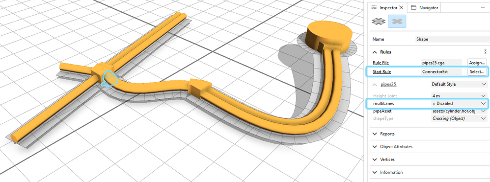

Thank you for bringing up this topic. With the changes to street networks introduced in CityEngine 2025, most legacy rules continue to function as before. However, there is an important change in how street segments connect to nodes: transition shapes are now part of the node itself. Since the lane information is not available on those shapes, creation of pipe extensions for multiple lanes is not supported.
To help illustrate this, I created a simple pipe network rule that demonstrates how to handle pipe connections to nodes under the new system.

The user needs to set the Start Rule "ConnectorExt" on the new node extension shapes. Additionally, the attribute "multiLanes" defines if a pipe or a square extension is created.
