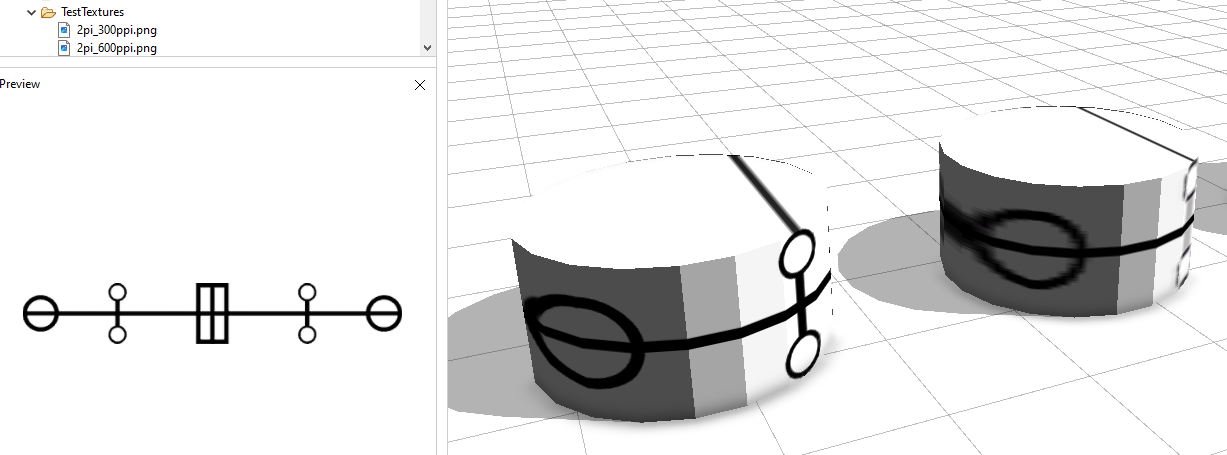

Furthermore, the same rule creates a far worse texture when I use the higher resolution file, as can be seen below. Why is that?
I attached the texture files, if someone wants to test this. This is the CGA for the above (top and bottom are textured too, but the concern here is the texture quality):

There must be a better way, I tried to make it by disassembling the side of the cylinder with comp(f).
I textured each side of the cylinder with offsetting
Hope this helps.

  	A
A --> comp(f){side : B | top : NIL | bottom : NIL}
B -->
	setupProjection(0, scope.xy, Cylinder_round, Cylinder_height, Cylinder_round-(comp.index/comp.total)*Cylinder_round, 0, 1)
	texture("images/2pi_72ppi.png")
	projectUV(0)
desert
