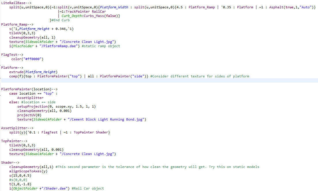

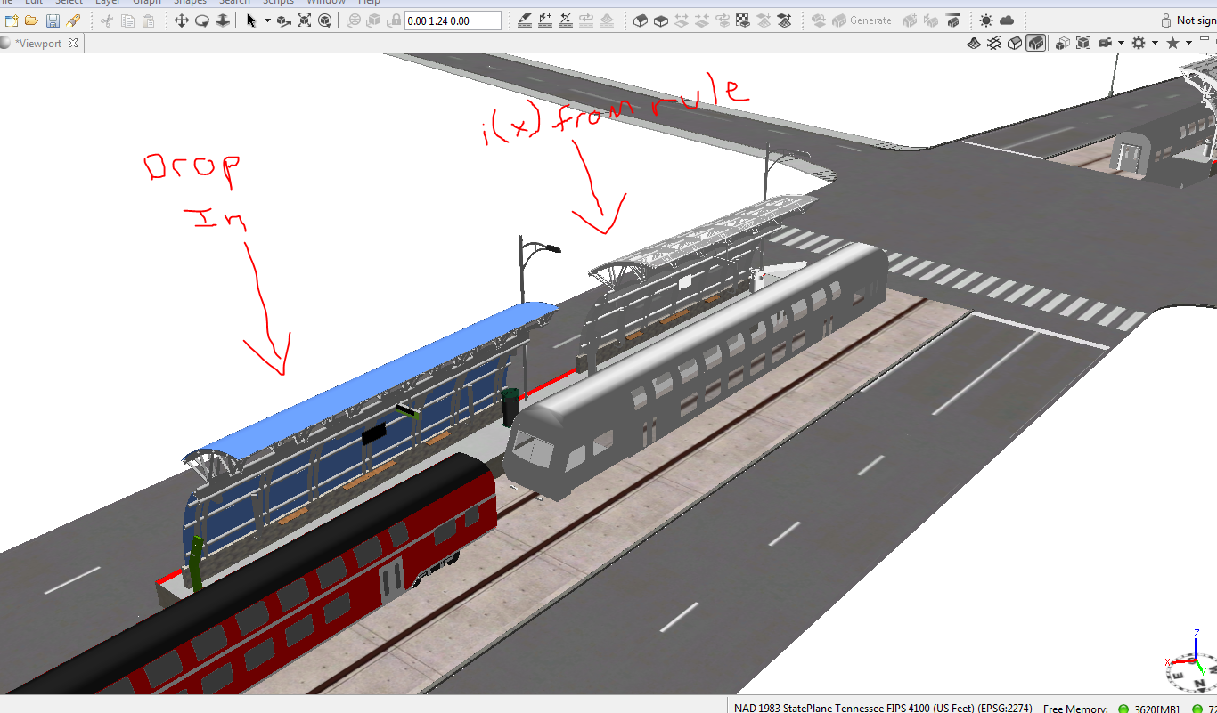

I am trying to insert (i operation) two pre-made static models for a lite rail stop model.  When I drag and drop the models into the scene they look fine.  However, when I use the i() operation through a rule...part of the textures are missing.  I know the dae files pointing to correct textures because I can drag and drop the models...and I have tried geometry cleanup operation...but still no luck.

Ok, I figured it out.
There was a color() function called on the lane the train is sitting on earlier in the code...I bypassed the color function and the train looks correct.

It was nothing bad on your end.  You wrote the "CenterLineReporting-->" to revert to a color() function if the user wants Usage instead of Thematic.  For some reason that was throwing off most of the textures in my Lite Rail assets.  I just simply bypassed with a boolean..
I will certainly share.  I have attached the code, models, textures here.
