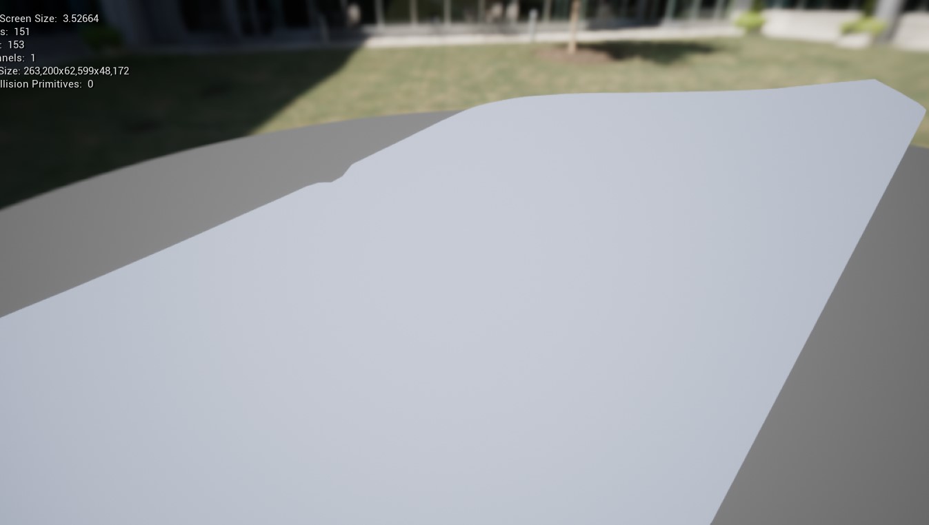

As a workaround I tried spawning a basic plane along the spline to use that as an initial shape for vitruvio, like so.Basic plane along splineBasic plane along spline

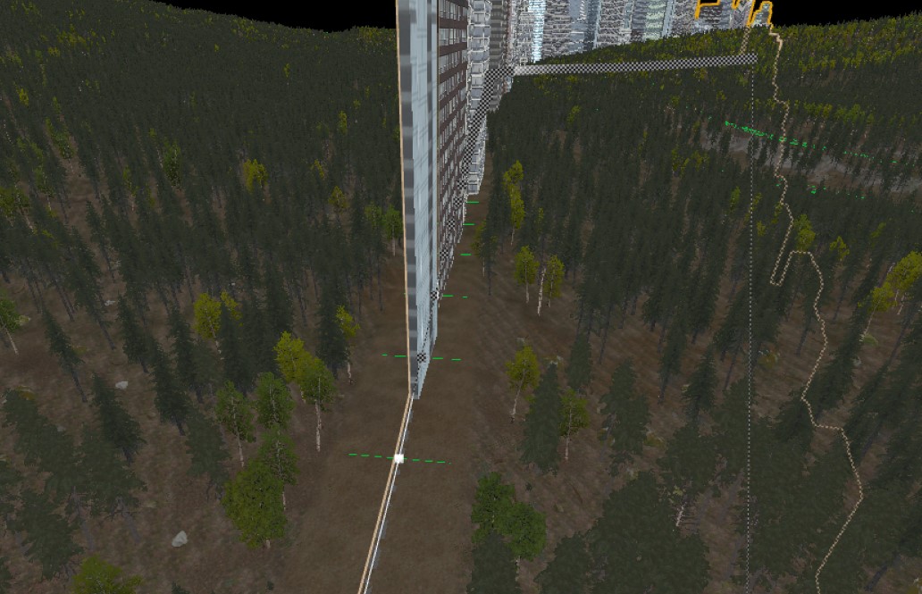

  I added a Vitruvio actor component and an RPK I made of the Complete Streets rule.  Only it just uses the spline instead of the shape.  I managed to get it to generate some narrow buildings along the spline,narrow buildings.jpg
but if I try it with a road, it generates an amorphous blob that is below the terrain.blob under terrain.jpg
The reason why the normal building works fine and no geometry is generated for the streets is that they require special UV coordinate setup on the initial shapes (see https://doc.arcgis.com/en/cityengine/latest/help/help-street-intersection-shape-uv.htm).
But we actually have an internal prototype using a very similar approach as you described to get streets (intersections are a bit more complicated) working using Unreal splines. I hope we can release it in a future Vitruvio version.
I'm building a scene that's primarily nature, but need roads and intersections.  Very much like this https://github.com/Esri/vitruvio/blob/main/doc/img/vitruvio_attributes.gif
Those streets are actually just normal Datasmith exports from CityEngine (Vitruvio was just used to generate the buildings).
I think for now the best solution would be to model the streets in CityEngine and then only export the shapes (not the generated model). Then you could apply for example the "Complete Streets" rule on these shapes in Unreal using Vitruvio (similarly to this https://github.com/Esri/vitruvio/blob/main/doc/usage.md#initial-shapes-from-cityengine-to-unreal-eng...).  Sadly this won't allow you to make changes to the actual street "splines" in Unreal.
I will let you know once we have a proper solution using the Unreal spline system for more advanced street modeling.
