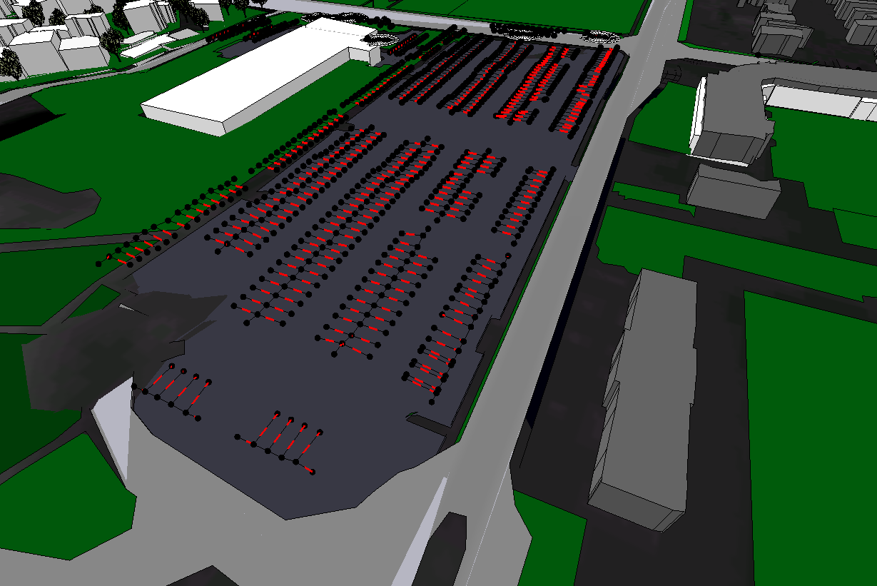

I'm trying to import a GDB that contains lines for parking spaces of parking lots into CityEngine, but am having some issues with removing nodes so that only the lines appear. Here is a screenshot of what I'm seeing.
Does anyone know how to deal with this issue?

I would suggest writing a rule to make the parking space lines.  First, enable shape creation (Street Parameters in Inspector -> set shapeCreation = Enabled).  Then, apply rule to Street shape that sets the line's color.

I think you want to click the button below. This removes the segments from view. You can alter the number of nodes via two methods:
1. Edit the date further in ArcGIS to reduce vertice count.
2. Use Simplify or Clean Up graph in CE.
