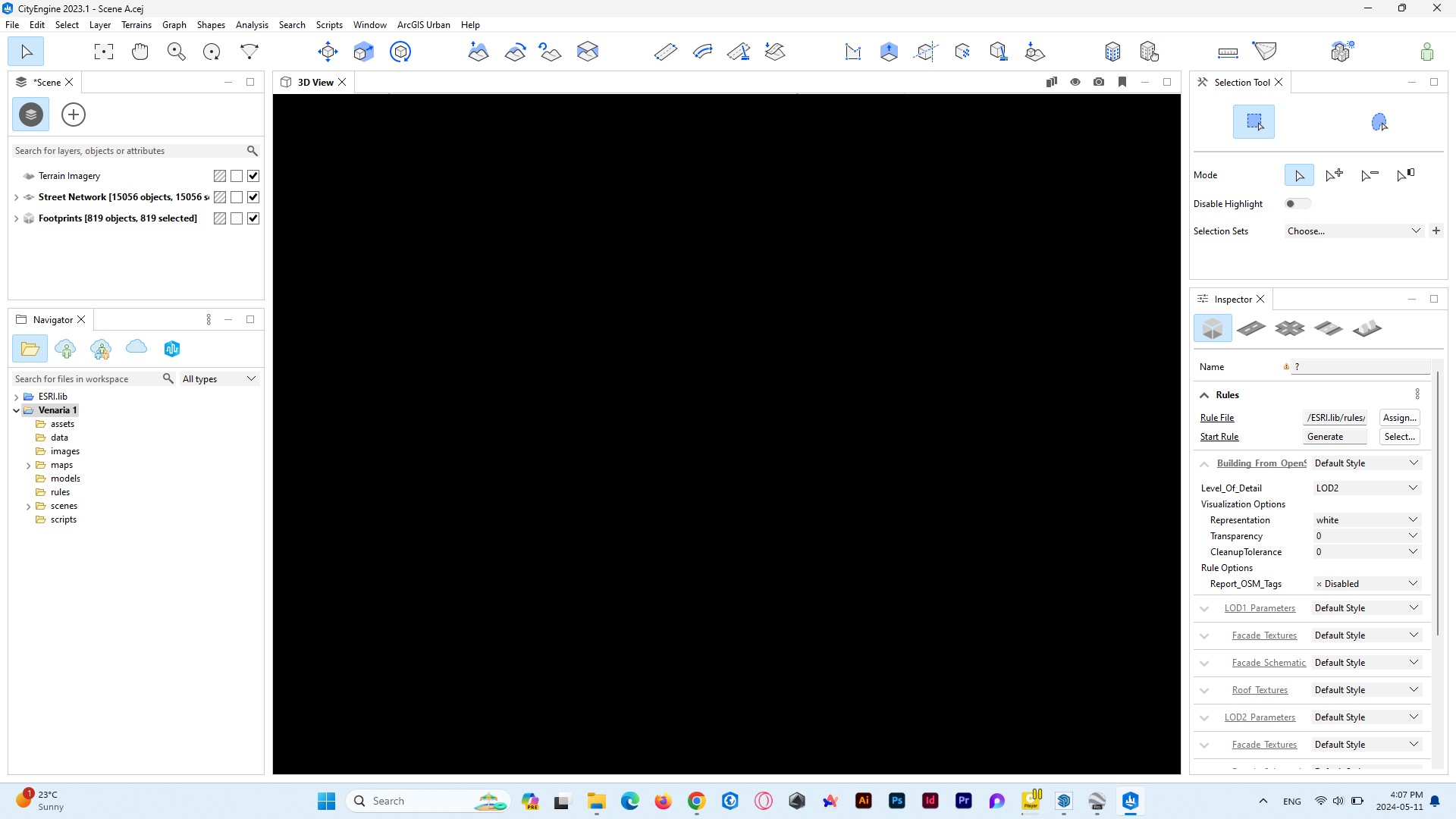

Hi everyone,
I've started to use CityEngine, but when I open the software my whole scene is black. Even I tried the upper solution to change the workspace location, but it didn'tScreenshot 2024-05-11 160909.jpg work. My whole operating system is powerful, and I use other Esri apps such as ArcGIS Pro and Earth. I also updated all the necessary .NET frameworks on my machine. but I am not sure what might be the problem.Screenshot 2024-05-11 160726.jpg

Hi @SAMANFARHADI,
This looks like a graphic card related issue.
  • Do you have a dedicated GPU in your setup or only the integrated one?
  • Are all your drivers up to date?
  • Can you share your log?
    • Windows -> Log -> Export Log (most left icon)

Dear Jonas,
Yes, the final thing that I looked into was my Nvidia Control Panel, and it seemed that the software was assigned to my integrated GPU. I changed that to my dedicated Nvidia one, and the problem smoothly solved. Great thanks

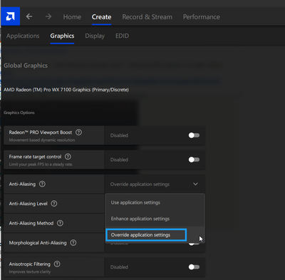

I have an important update for all users of AMD Graphics:
If you encounter a black viewport, open the driver settings and ensure the global graphics settings for Anti-Aliasing are set to "Override application settings".
