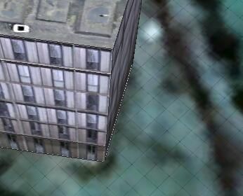

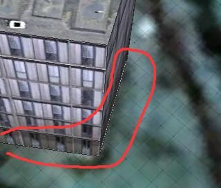

I would like to ask why this white line appears on the roof of a building or at the gap between the building and the ground, and how to remove it?
Another interesting feature is that this white line may disappear at another angle.

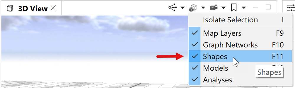

I'm not sure.  Could it be that shapes are shown?  You can show/hide shapes using F11 or through the visibility settings menu in the viewport here:
