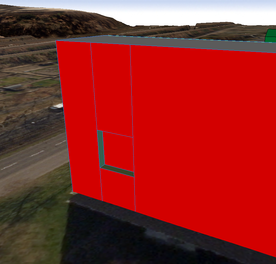

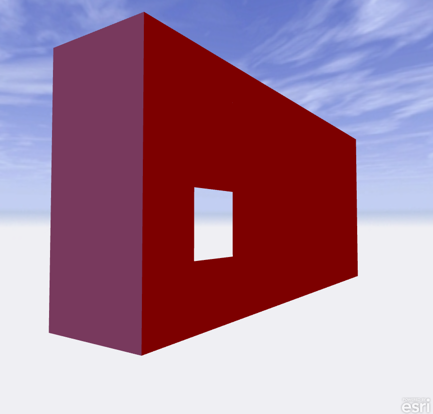

I've been creating a bunch of buildings with negative extrusions in CE which works fine with my method below. However, when I checked them in the scene viewer, the buildings were full of holes. How do I avoid this?
Simplified script:

Screenshots:
Scene viewer:

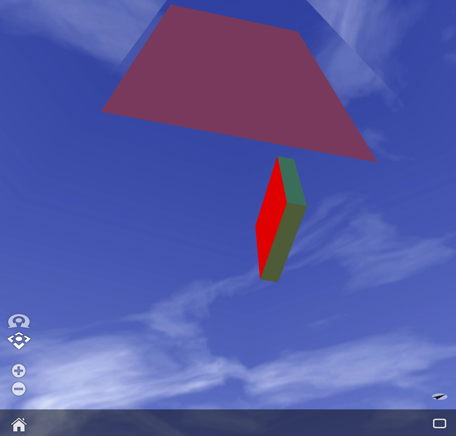

View from inside/bottom:

You need to fix the normals of the faces.
Extruding negative reverses the normals. CityEngine by default shows both sides of a polygon. The WebViewer does not to be more efficient.
Rather extrude positively, then translate back.

Thanks, that fixed it.
Is it possible to enable this "viewer-view" in the editor?

Yes, activate 'backface culling' in the viewport render settings (cogwheel menu).
