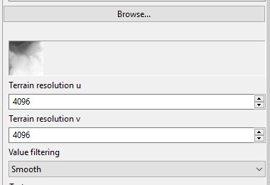

thanks for reply. I don't think it is a Python limitation (but maybe I am wrong) because when I repeat this process by hand It also creates terrain with default resolution of 1024x1024. And I can manually increase the terrain to 4096x4096. And I was wondering if same could be done using some method in python.

Unfortunately there is no way to increase the resolution with python - this is a missing feature.
I'm aware it is possible in the user interface.
