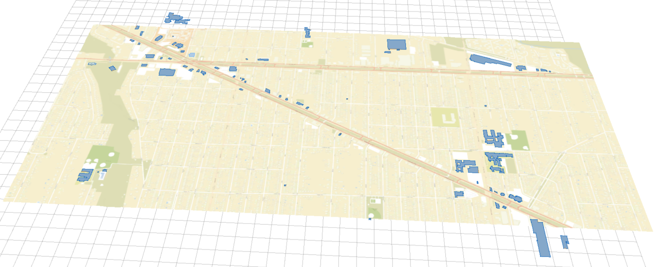

CherylLau
When I try those exact bounds, I am able to get building footprints (shown in blue), and they match the available data on OpenStreetMap, so I don't think I'm missing any footprints.  Do you not get the footprints in blue below?

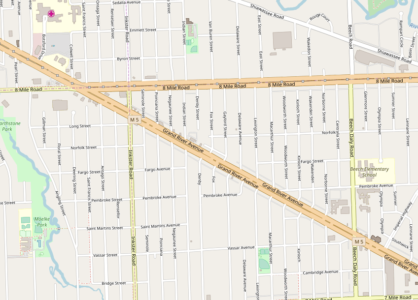

Here's what's available on OpenStreetMap (building footprints are dark gray):
JasonPietka1
In your images you are not getting the residential home shapes.  That site SEMCOG is nfreaking awesome.  I got the shape files for residential homes from there.
CherylLau
Get Map Data downloads what is available in OpenStreetMap.  If it doesn't exist in OpenStreetMap, then it won't exist through Get Map Data either.  These footprints don't exist in OpenStreetMap as indicated by the second image I posted.
