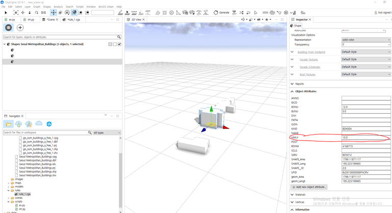

How to call the height value of the shp file data and give the building height value in cga or python.

plfontes
Try to connect the object attribute to the model by matching attribute names. Change your attribute name on your code from 'attr Building_Heignt = 20' to 'attr NMLY = 20'.
I believe CE will use the value '20' only if it doesn't get any value from the object's attribute.

leehwichan

(I wrote a script like this and I don't know where to fix it.)
plfontes
