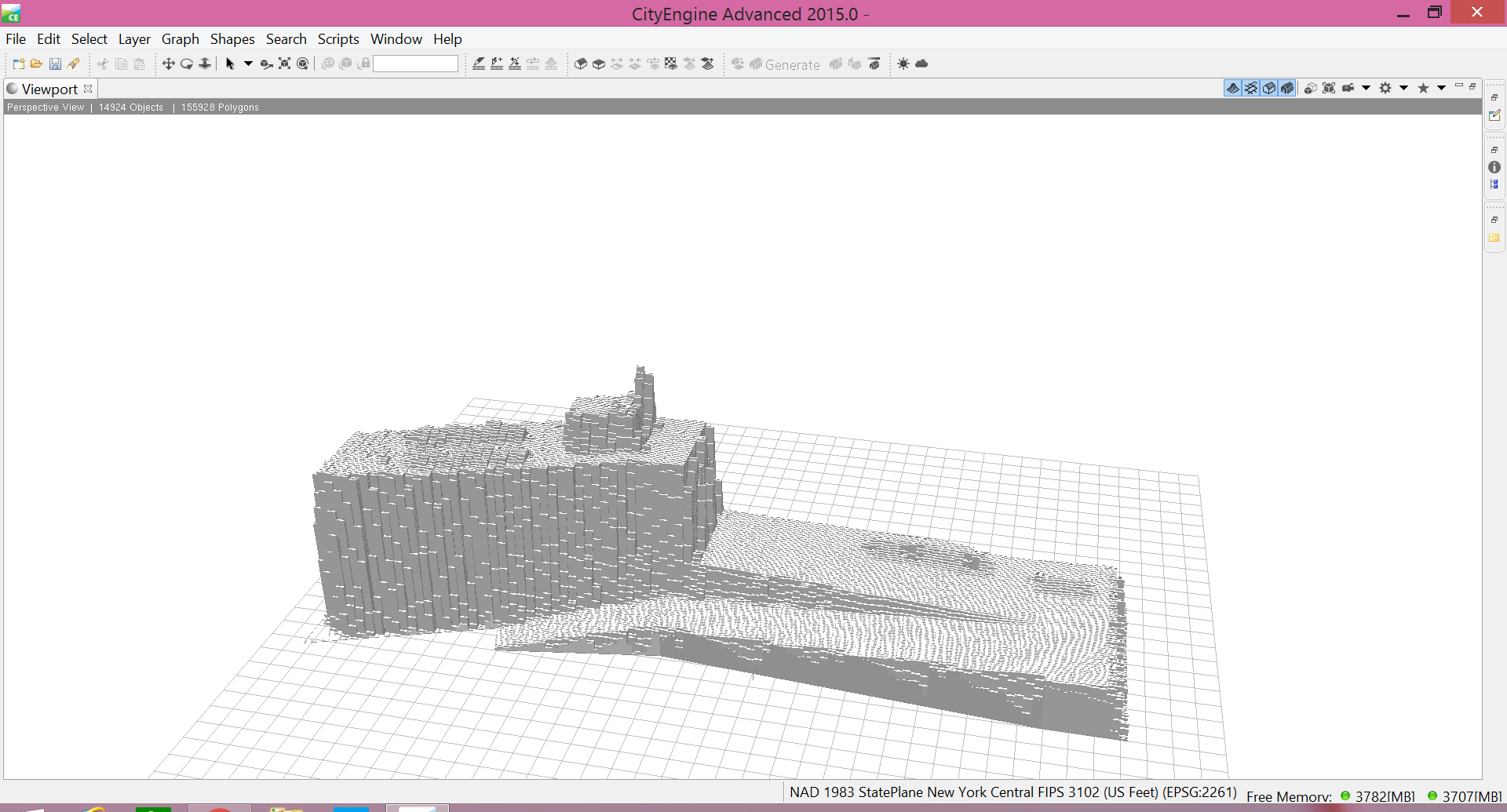

Hi guys,
The grids in the following picture is the .shp file which is exported from ArcGIS. Then I read the MEAN_Z attribute from the Object Attribute and attributed it to the following grids.
After that I obtained the building in the following picture. Now my work is to modify this building. First I want to change the heights of different parts of the building. My problem is how to apply different rates of change to different parts of the building.
I tried to write the code like this:  attr MEAN_Z
                                                     attr height= MEAN_Z*0.5;
but the result is the height of the whole building became 0.5 times than before which is not what I need.
How can I divide this building into different parts based on so many grids and how can I apply different rates of change to different parts?

CherylLau
Ok, so I was under the assumption that you had one shape with multiple faces.  In this case, the split operation would work, but if you had multiple initial shapes, there's no way to combine them in the rules.  I would suggest combining all the shapes into a single shape either in CE or in the software you are using to generate the shapefile.
You could combine all the shapes into one shape in CityEngine by selecting them -> Shapes -> Combine Shapes.  This will give you a single shape with multiple faces.  Then you can apply a rule to the single shape.
Or, you could combine all the shapes into a single shape before you export your shapefile.  It should be a similar procedure as in CityEngine (select all the polygons, then find the menu item to combine the polygons).

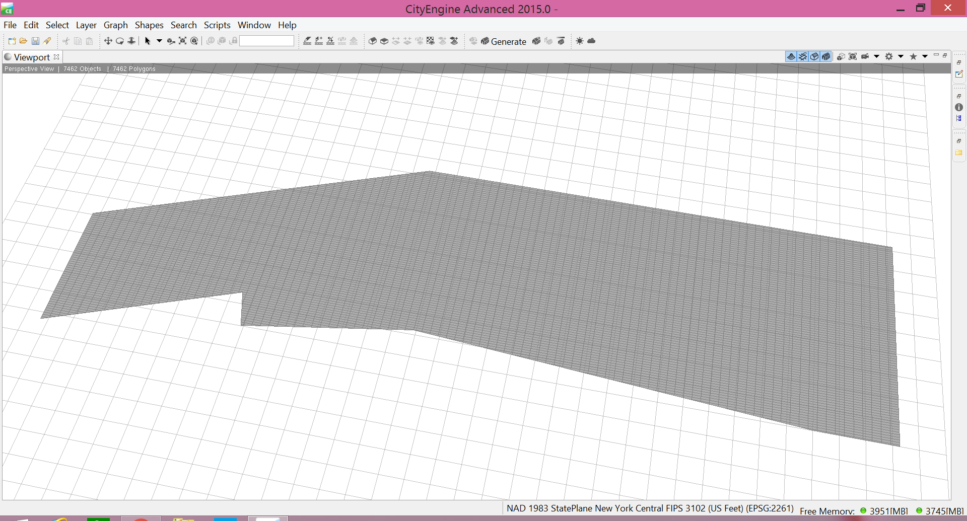

Yes, when I referring grids I mean the initial shapes imported from the .shp file. In the following picture you can see many shapes in gray color, these are the "grids" (shapes) which are imported from the .shp file.
But in my case, I want to combine all these shapes together and let them become one building. In the picture, all these shapes combined together shows the footprint of my building.
CherylLau
TianfangJiang
Deactivated User
Cheryl, thank you so much for your help! I think you are right, I should combine all the initial shapes together before I input them into the CityEngine, there is no way to combine the initial shapes by the CGA rules.
