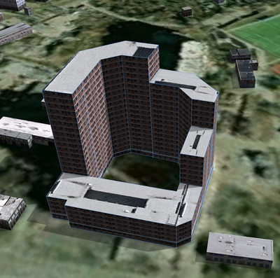

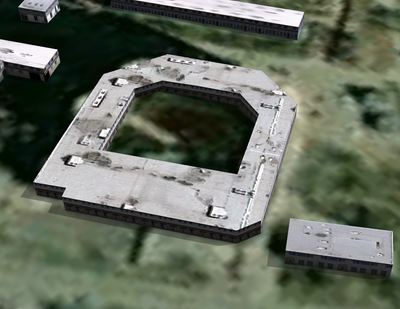

@JonasObertuefer You are correct, it does, but only if the osm_id attribute is a string/text and not a considered a number. So then my next question is, is there a way to make this work as is, or add a text/string attribute to all of the footprints in bulk?
Edit: I have exported out the shp file, added it to ArcPro, done what I needed to do to the attribute list, and then reimported it into CityEngine, but then when the same rpk is applied, it does not generate the buildings the same way.
Before export:
After export:
Nothing has changed about them, except an added attribute making the osm_id to a text/string.
JonasObertuefer
Is this a RPK of the Building_From_OpenStreetMap.cga rule? This rule requires some object attributes of type float to work correctly:
"building__levels", "roof__height", "roof__direction", "building__levels__underground", "building__min_level", "min_heigh"
In python you can check the type of an attribute with type() and then cast to a certain type as required with float() or str(). In case of the OSM id you probably want to remove the decimals before converting it to a string, this can be done by first casting it to int()
